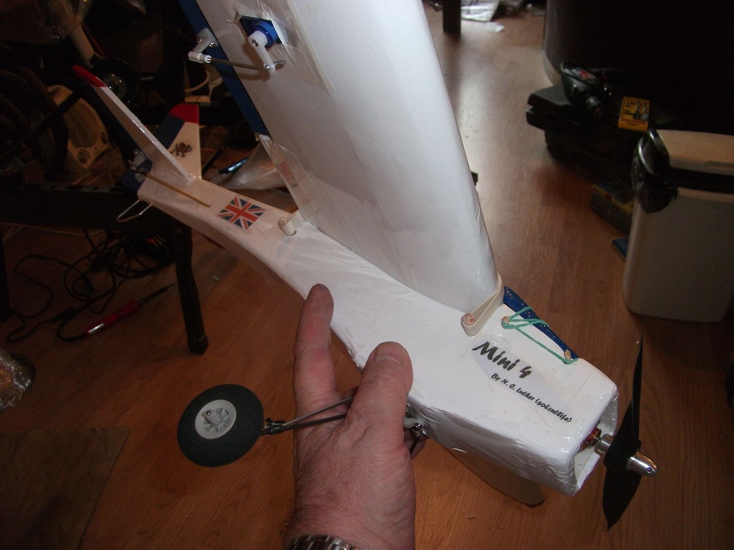

Heres my little Mini 4 (half size WOT4 rendition). 710mm span.
You can see by my holding it how small it is :
Here's her all finished ready to fly :

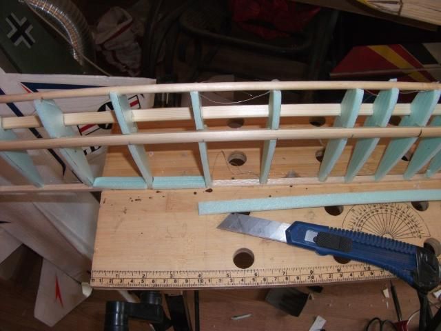

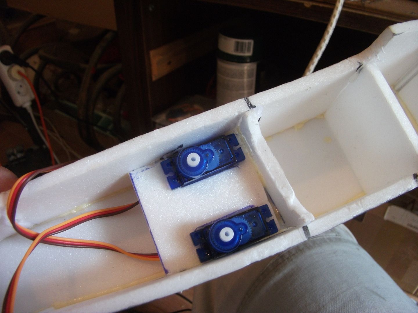

Now as to structure : The fuselage is 6mm Depron with no wood except to carry motor mount, wing bolt and main legs.
Wing is fully built up with foam ribs and pine strip spar. Ailerons / tail parts etc. are all plain 6mm depron.

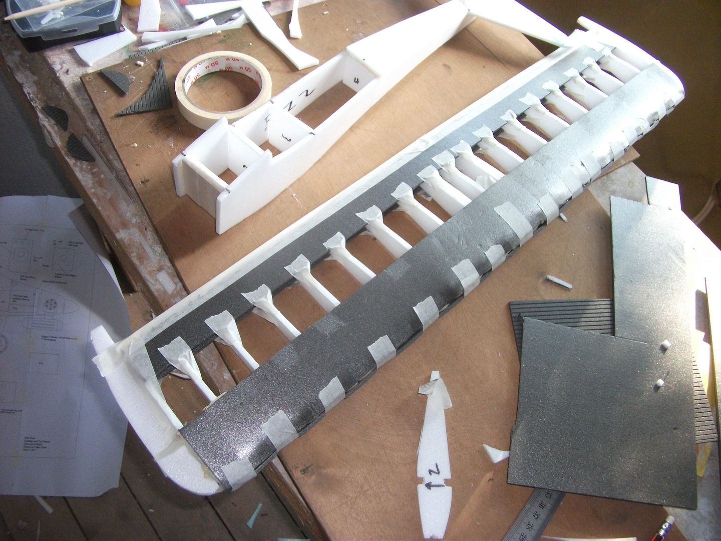

3mm Depron sheet over :
Then all covered in standard HK white Iron Film. Only action to be careful on - is use MINMUM heat to avoid damage to underlying foam.

Wow, that is one unique way to make a wing!
You mention the ribs are foam, then covered with depron. Are you using the words 'foam' and 'depron' interchangeably, or are they different materials?

I have two basic foams .... Green underfloor insulation that is stiffer but more brittle than Depron. Makes excellent ribs. For general build though Depron is better as it will absorb stress much better.
But on thinking about it - this model I did use Depron for the ribs !!

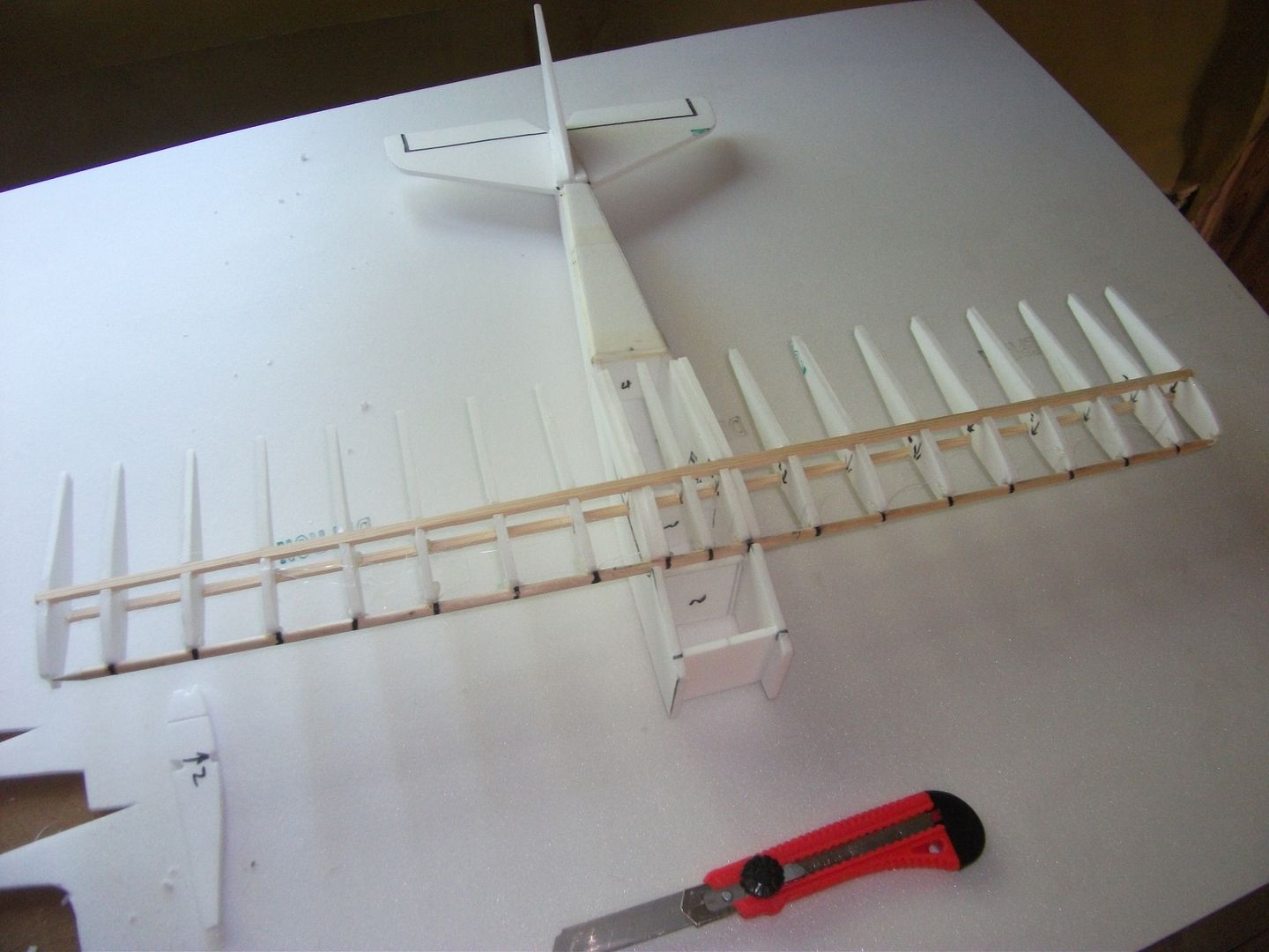

This model - another wood / foam combo uses the green for ribs, Qbee :

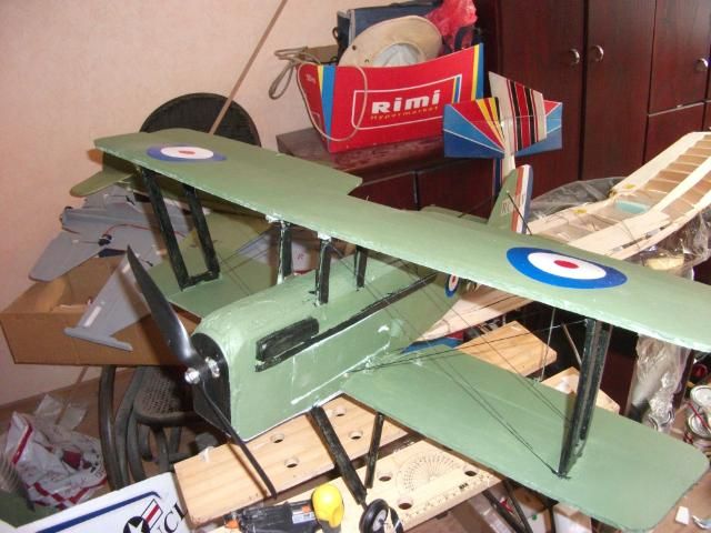

Here's a model made nearly all in green Floor insulation :
No covering though - cosmetics by Household water based emulsion paint. Vinyl stickers from local Decal Maker Shop ...
